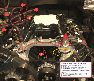

I had some time (and light) to look this weekend. It appears the leak is higher. Looks like it is coming out of the gasket under the thermostat. There is some kind of water chamber that runs from one side of the engine to the other where the heater hoses connect. What is that? Looks like it is leaking there. Pulled the thermostat cover and can't get to the back bolt to try to tighten it. May have to pull the intake to get to it? Looks like alternator, brackets, etc all have to come off to replace that gasket. Not as easy as 4 bolts on a water pump.

Found a diagram of the cooling on the site and mine is leaking where the yellow circle is. This pic shows the coolant bypass up high and held on with the thermostat housing bolts on the drivers side. Mine has the bolts separate and it may be part of the intake manifold. Mine goes low closer to the block instead of up high. I know it looks like I can't get to the back bolt with the intake on. Anyone know anything about changing these?

I had a leak at the crossover, and my crossover goes down as you describe (I have an '07). I could see some coolant puddling up under the intake manifold, between the heads. I don't recall which bolts I had to remove, but I ended up removing the crossover and the crossover gasket. The new gasket was difficult to slide back under the intake manifold, so I had to pry the manifold up ever so slightly and then the gasket (lubricated for an easier install) was slid into place. It wasn't too difficult, but it certainly wasn't as easy as changing the t-stat on my old mid-90's Ranger.

Thanks Dustin, I may give it a shot. It really looks like only one bolt on the back side is the real issue. Maybe with a 1/4 universal and 5/32 socket I can get it out without removing the intake. Maybe next weekend.

Awesome and good job on finding the leak, that's definitely a leak location I haven't seen posted on here before.
If you want to try your luck and go cheap, some RTV liquid gasket might seal it up for you... all depending on what Ford is asking for those seals, I guess. The disassembly looks fairly straight forward. When I rebuilt my alternator, it literally took like 15 minutes to remove it and reinstall.
