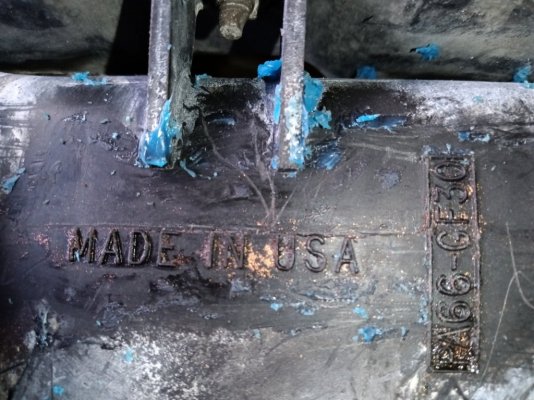

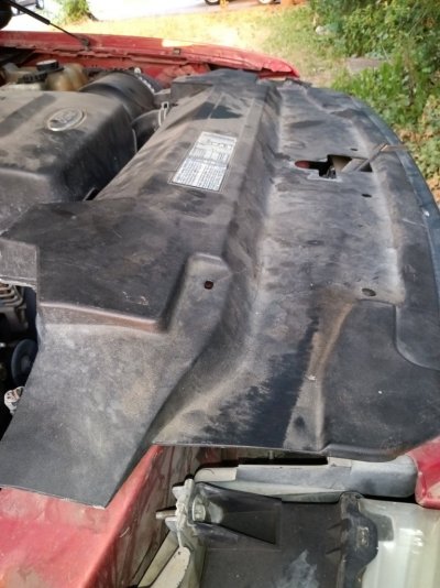

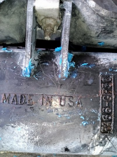

I Know this is an old thread , but hope this helps someone ,
i was having the same issues could not find a leak , did a compression test
leak test and nothing , so i was going to change out the radiator
and when i pulled off the top cover found my leak ,
a small crack in the top part of the radiator see photos , so i tried some stop leak it did not work .High temp RTV nope so off to the junkyard to get one , i can't afford $200 to replace it with a new one Hope this helps
