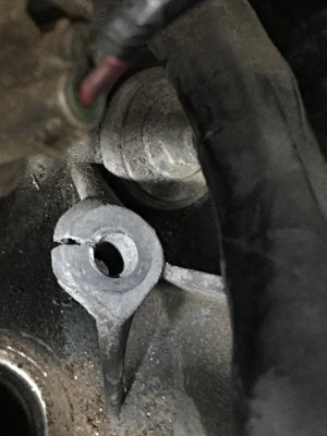

I was tighten bolt on last coil on driver side and the thread where coil boot goes is cracked what are my options here. Coil plug is loose and causing truck to shake but no code

When that happened on my last truck the shop removed one of the bolts on the intake manifold and made a little bracket to fasten in there and press down on the coil pack. Fixed the issues.

Maybe a strong zip tie through that hole and the coil mount hole, and how tight can you get it. Or a new intake manifold.

JB weld or JB Quick and build it up some. You can fill the hole whole if you want or make it smaller and then run a drill through it and or even a tap.
You should not need it.
I have had plenty of modulars with no bolts on the coils and them just sitting there and they usually are just fine,.
