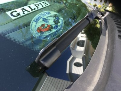

Today is the day I get it changed........can not believe my luck with this...hope they can change the windshield with no issues and that they don’t make it look like it was changed..

The first company backed out..said they could not calibrate it...now the second company said they don’t calibrate I need to bring it to a dealer. Safelite said they calibrate for 300. This windshield is a bugger...

Ok ...all done... back to normal...700 for the Oem stuff with all the sensors...he managed to transfer the union sticker..
