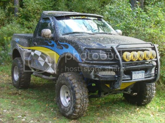

I've never needed to re-align any truck that I have cranked torsion bars on... my old 97 f150 had 38s and no problems... expy has keys but only reason was the torsion bars were removed for fabtech...
sold but still in town and still only TT and the 38x15.5 are going on 4 years and no problems
and expy is going on 2 years... just my .02
