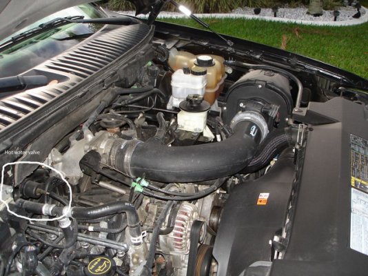

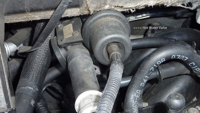

Has anyone been working under the hood lately ? Most times it's caused when someone knocks the hot water valve's vacuum tube off. Like when someone does a sparkplug change, or even an oil change.

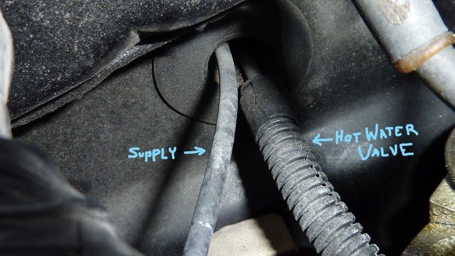

Check that this vacuum tube is still connected to the hot water valve....
And no leaks in these lines going into/out of the firewall ....
