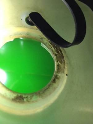

Dealer put Motorcraft Gold coolant in 2009 Expedition after replacing water pump. However, they did not adequately top off coolant afterwards and the reservoir was dry. Dealer told me they put in Motorcraft Gold, which I confirmed by opening the cold radiator and inspecting the fluid. Dealer told me under no circumstances to mix the Gold with any other coolant because it is not compatible. Returned to the dealer for them to top off the coolant. Got home and looked at the reservoir and of course, it is bright Green! Opened the radiator, and what was a slightly low Gold color coolant is now also bright Green.
Are Gold and Green actually compatible? Or, do they need to tow it back the the dealer, flush the entire cooling system and refill with Gold coolant?

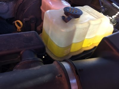

Dealer did the right thing. They flushed it (twice) to get the green out, and refilled with all Motorcraft Gold (per Ford specs). This what I was advised to do when I called both another dealer, and Valvoline. The service advisor at another dealer told me to have it flushed out because I was essentially doing an experiment with two different fluids. Valvoline said their coolants that meet Ford specs are not compatible. When you look at the spec sheets for the two Valvoline coolants that meet different Ford specs it is clear that they are different formulations. The last thing anybody wants is actual engine damage and corrosion of engine and cooling system components by something so stupid as running an experimental coolant concoction. With over 200k miles on the engine, and a fresh expensive dealer installed water pump, I can´t afford to sacrifice the Expedition for the sake of science. It was an extra pain, to deal with but I am glad that I checked the coolant color before and after the new water pump, and again after it was topped off. No reason to pay dealer prices for below spec work.
Green before, and gold after photos are below.
