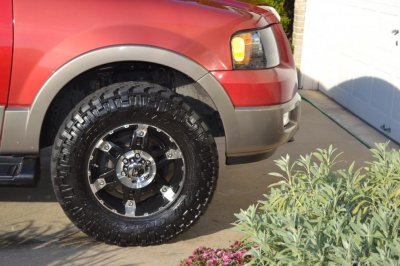

After installation I LOVE it but It's either my eyes or the truck is in need of caster camber adjustment? Seems they tires are up on the outside edge or it's just me?
Anyone else in need of these adjustments after install? I have a 2.5 inch kit.
