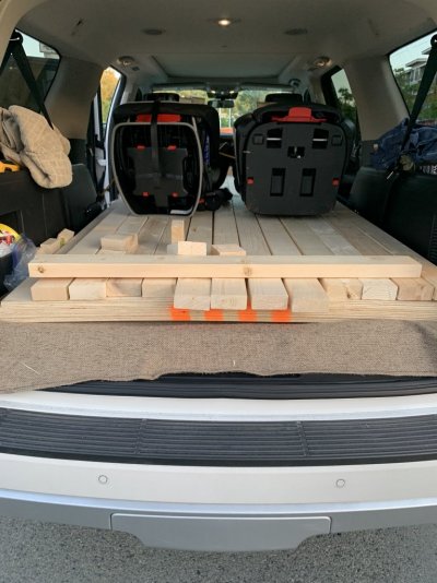

I have 2018 Max, so can speak for it. Regular, just my speculations...
1) Max - yes; Regular - most likely no (see #2)
2) Max - yes; Regular - most likely no, even if you move the seats all the way, you might need to remove the central console between the front seats or elevate your load to clear it.
3) Yes
4) See attached, sorry just one pic of my home DIY project... had to remove child seats from the second row to fold it down
PS: my biggest concern was the load could smash the climate and audio controls for the second row on braking, so had to put some 2x4 behind the front seats.
