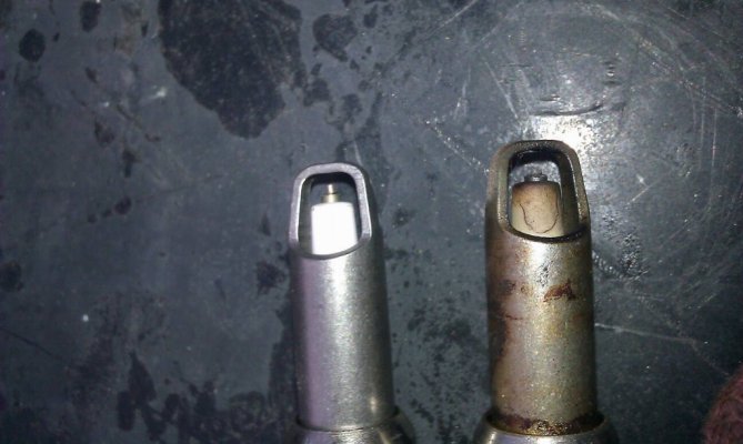

I replaced the plugs yesterday. It wasn't too bad. Took me about 1.5 hours. And I was moving slow because I was tired from working on a Topkick earlier. After seeing the plugs at 52k I wouldn't want to wait any longer to replace them anyway. They were pretty wore out already.
