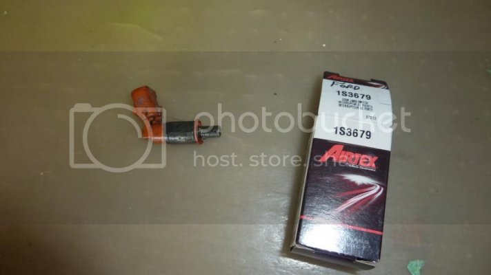

Things I've tried: WD40! And for the love of god I don't care if it worked for you! It didn't for me. Removed driver door skin and plugged in a new door ajar switch. Pressed with my finger to no avail. Bought a new VSM and had it installed and flashed.

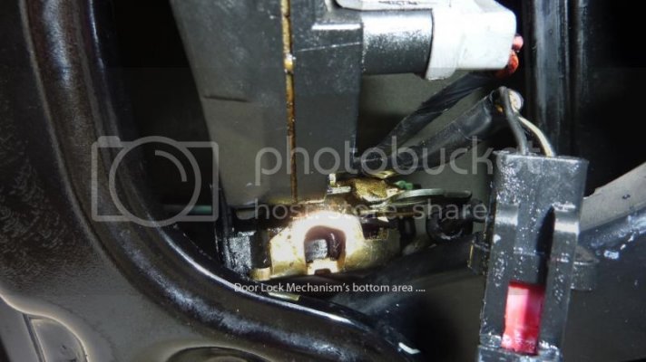

2003 door switch... newer ones are slightly different...
Bottom of latch, where switch mounts.... a quarter turn releases the switch....

It is a 2003 and no door turns off the radio.I never installed the new switch. I unplugged the old one and plugged in the new one. Pressed with my finger to no avail.
I checked the plug for the switch with a test light and there is no power there. Is that normal?
