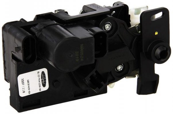

I also find this switch on eBay, what is this for?f92dad31dd1decdbd824e6044336dacc.jpg

Go look at your liftgate and check, but that looks like the glass release switch to me. I did find the liftgate latch at a slightly lower price at another Ford parts supplier online. It's about $80 or so. For that cost and the amount of work involved I would just replace the latch and be done with it.
https://www.fordpartsgiant.com/part...=luggage-compt-tailgate-lock-controls,,<43150
It's raining so I won't mess with it until it's dry, I will take it apart and look at it.
Thanks for your reply.
