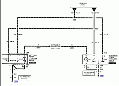

I have a question, does the lock and unlock button have different wiring? Cause it locks just fine, only the unlock has a problem. I checked the module and its making clicking sound. I've read that in your case both ways doesnt work.

Yeah the drivers door has seperate wiring than the rest of the doors, and there is a unlock wire and a lock wire. Here are the wiring diagrams that I got from Alldata, maybe they will be of some help to you!

Great!! I'll check it out tomorrow!! Will post the results!! Tnk u very much!! I hope i'll be able to fix it!! I really appreciate it!

Before anything else, thank you for your help w/ the diagram.Heres what happened, i couldnt find the broken wire, so what i did, i tapped the wire to the left rear door, now atleast all doors lock and unlock through remote, keypad and power doors inside. When i was about to start my truck it wont start, i have to disconnect my horn cause it wont stop making noise.even if i lock then unlock the doors, still wont start, all lights flash everytime i open the door even though i lock the doors inside already, all lights still flash.if i put the key, no crank. And i only have 1 key.i took off the negatve of the battery for 15mins, still no luck. I dont know what to do now, i dont want to get it towed to the stealership. Could it be the PATS? if so how can i fix it?

Finally i was able to fixed it, tapping the wire going to the security module was a bad idea. Everytime i unlock the doors, it will unlock but by tapping the wire to it, power current will go back to the module arming the truck again though doors were unlocked already and prohibiting me to start the truck. What i did is i cut the wire and connected it to the rear door power source and connect it to the front door actuator.anyway there's a broken wire that i couldnt find in the front door so it doesnt make a difference if i cut the wire or not cause its already broken.maybe someone could make use of this situation that i've experience.
