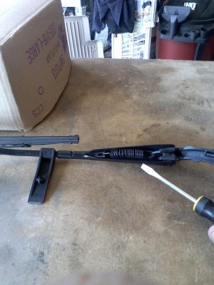

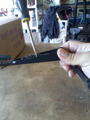

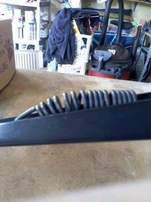

Okay, I put my theory into practice and it worked!!! The rear wiper arm definetly moves with more ease and works everytime tested.
Here is the fix - You will need a flat head screw driver and a 1/2" wrench, that's it!
1. remove rear wiper arm assembly, remove plastic cover from base and loosen & remove nut. Then pull off rear wiper arm assembly, you may need to pull with some force! See pic #1 & #2
2. Turn over the wiper arm assembly. Backside facing you. Next, pry open / expand wiper arm spring (bend wiper arm back which stretches the spring)
See pic #3
3. place flat head tip of screw driver into the first spring closest to wiper.
4. release spring, trapping tip
5. twist flat head tip which create an opening (about 1/8") between the spring loops.
See Pic #4.
6. Spring wil look like bubbled (See pic #5) after you enlarge a few of the spring coils.
7. Repeat from step 3 with the second spring and so on until you feel you created less tension and a flatter appearance from the base of the arm to the tip of the wiper blade.
8. Reinstall and test....you should see difference in how freely it moves.
9. Yes, this proceedure applies less pressure to the glass but it still cleans the water off of it properly.
Maybe if the mods agree this can be a sticky for those who think its a wiper motor failure but really is too much tension from the wiper arm spring.
Let me know how you make out fellas! It worked for me!
