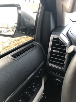

is anyone getting a rather loud and annoying rattle from this area?
I can’t seem to locate it exactly, although it could be the gap down by the lighting controls?
Also, the window here starting whistling recently, but I don’t see anything wron with the door seal...

I found the rattle. It’s the triangle plastic thing at the front of the interior door. Pushing on the windshield actually makes it pop.
What’s behind that? Could that also cause the whistle?

Oh my! I have this same issue!!! It has been driving me crazy. Some days I don’t hear it but other days it is non stop.

I do not but I think you are right on the location. No way the dealer will be able to help me on this.....and it is driving me crazy. So annoying..... it is like a crackling sound.

Does it pop or crack when you push on the window itself?
I haven’t tried to push on the window. I probably have tried to push on every single piece of plastic however! It is super annoying. I do hear it when I open the door though.....I will try and push on the window next.

Does anyone know what is behind that plastic piece?
In mine there is a speaker there. If you don’t have a speaker I’d assume it’s a void with a wire for a speaker.

I can push on the triangle plastic piece and force the rattle. Problem is it does it all the time when I drive over any type of bump.

I have an appt next Saturday and I am going to mention this. It is driving me nuts. I will let you know if I find anything out......

At dealer and the rattle/cracking noise has stopped!! I think I figured it out on my own. Right above in your photo I pushed in the seal that goes around the door and heard a slight pop (sounded like I pushed it into place). When I am driving I hear it pop back out and then I just push it back in. Seems to have stopped. My noise was non stop too. Fingers crossed this is it. It was seriously driving me insane.
