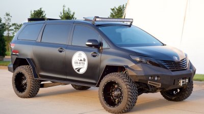

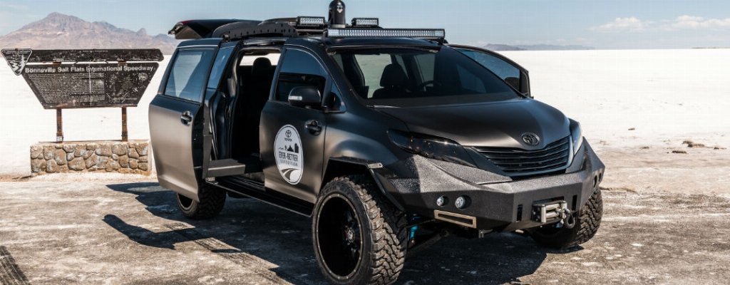

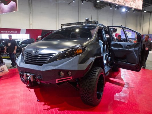

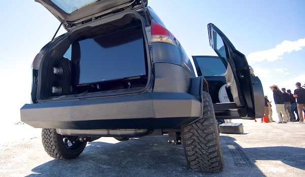

So by the looks of it
Plan A: drive on the beach, then drive off the beach.
Plan B: start using one of these bad boys
Plan C: let's have some real fun
Plan D: if all other fail...
B-McD
Jul 12, 2016
240
114
Illinois
I'd drive that minivan!! I wonder if the sliding door clears those fender flares??? o_O

Nope, but it opens just fine.
If things couldn't get any worse, front doors are suicide.
Wtf its a real van? I thought it was photoshopped. LoL I guess might as well it's the only minivan that offers AWD
