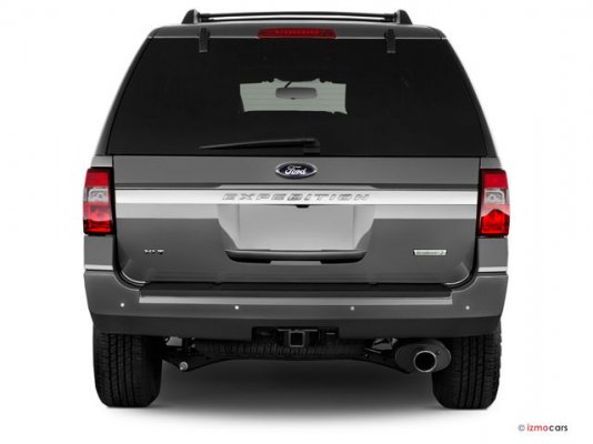

I’m not a fan of the big muffler out the back i like the pipe out the side better. Had to pick a better pic of the earlier 3rd gen lol, that puke earth color was awful.
