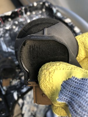

Got to mine today. No big deal pretty simple swap.
I had no issues getting the connector off the coil. Pop the red tab, push up, push grey tab, pull down.
While taking the plugs out of a hot motor is a NO NO. I thought maybe trying to pull the coils off while warm would be a bit easier as the spring and rubber boot would be more pliable. Mine pulled off prettt easily only one issue.
DO NOT TRY TO PULL THE COIL OUT WITH YOUR FINGERS UNDER THE RING ONCE YOU GET SOME SPACE!!!!!!!! The ring is ultra thin. The rubber underneath is super thick so I am hoping this will not cause issue. I just won’t be fording rivers anytime soon.
Overall not bad. Though I still find Ford’s 100k change interval to be complete nonsense.
Most plugs gap had spread to between .040 and .045
