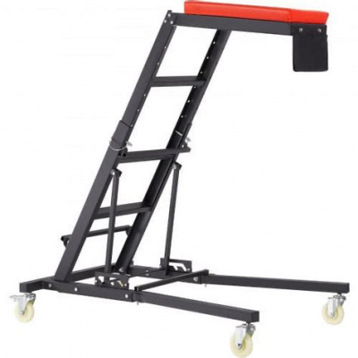

If you think you will be doing a lot of work in the engine compartment, you could consider a topside creeper. They have a step or two and an adjustable height platform/rest to lay on to access things like those spark plugs. Downside is that they take up a lot of real estate, even folded up. 1730246429360.png

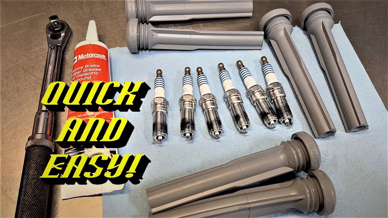

This might help. It’s on an F150, but should be close. He’s outside Chicago, so my plan is to take to him. Brian does a lot of Ford how-to videos and has a good following.
