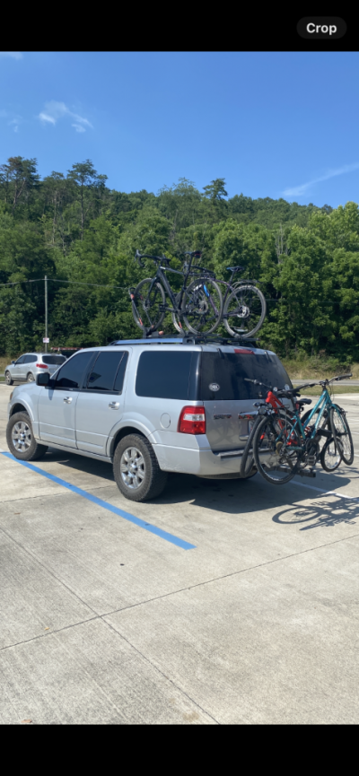

My 2013 expedition has been cranking a while before starting.
The engine has roughly 100k on it and the machine as a whole has 280k on it.
I had replaced the fuel pump, did NOT fix it.
Finally with the advice of one of my work mechanics, I replaced all the injectors. This FIXED the problem.
