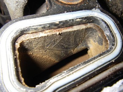

After reading a few posts about the intake manifold water jacket issues, I decided to pull mine and see if that was it. I 100% have a bad manifold heater jacket that needs repair, but could this cause all of the air getting in there?
The top of the intake to the coolant crossover was where the issue is- NOT bottom of the manifold to cylinder head
See pics
http://www.expeditionforum.com/attachment.php?attachmentid=10465&stc=1&d=1430533808
http://www.expeditionforum.com/attachment.php?attachmentid=10466&stc=1&d=1430533821
After further inspection, The rear driver side coolant jacket seemed to have a crack in it? Could just be a cast line- not sure.......
http://www.expeditionforum.com/attachment.php?attachmentid=10467&stc=1&d=1430533838
Do you guys think the Manifold issue, which is common, could cause this air problem?Could it suck air? Would that make it fail the coolant/air test?

You may be overlooking the cause. Since it failed the combustion gas test I would ask myself what are the paths for the gas to get into the coolant. Two come into my mind, head gasket and cracked head or block.
You may consider draining the coolant, removing the t-stat, filling with new coolant then checking for combustion gas again.
If it fails again there are a few heavy duty block additives used in big tracks that may allow you to get by for a while.
Please let us know what the outcome is regardless of what you decide to do.

thanks for the advice so far- I plan on changing the intake manifold to repair what I can see as two possible spots (both aT COOLANT CROSS OVERS) for coolant to leak out/air to get in

I had the exact same issues on my 03 expy. ..changed intake and it runs really good now but I'm chasing a bank 1 and 2 lean check engine light
