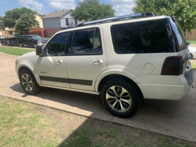

For the record, 2004 F-150 rims fit without any mods on a 2014 Expedition :
