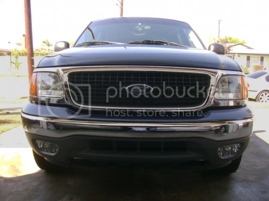

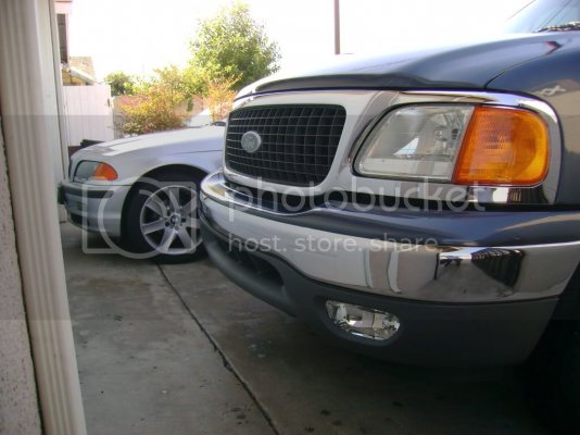

Finally had the chance to buy the lower front bumper and foglamps to retrofit into my 2000 XLT as mine didnt have fog lamps.
if anyone has any input with regard to wiring or bracket issues please feel free to chime in. I will post pictures of the install once I receive it

Arrived more than a week ago. Finally got it installed.
Lamps are made by DEPO. wanted to go the OEM route but only there are no oem clear fog lamps to match my oem clear headlamps. Also found out the fog lamps are prewired (woot:D) and I probably just need to buy the correct switch with the foglamp option.
However I wanted the foglamps to stay ON even when I flick the high beams. So I ordered a separate harness which I will wire separately

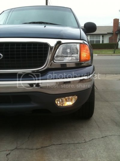

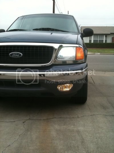

got the harness yesterday and spent a good amount of time in the garage. anyway here it is
Park ON, Fog ON, Headlamp OFF
Park ON, Fog ON, Headlamp ON
so now I can flick my high beams and the foglamps wont be affected. I couldve used the factory harness to rig the fogs but I decided to keep it clean so I installed a custom one and left the factory harness alone
and I went with yellow bulbs for the fog lamps :)
