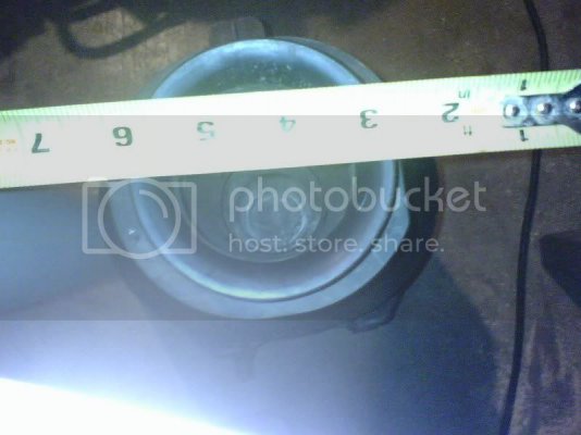

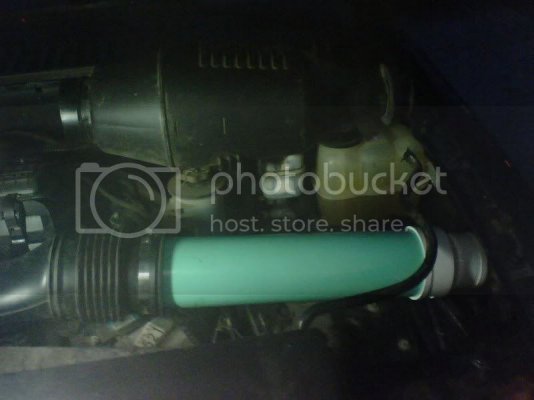

Got rid of it today! The factory intake is over 4" where it goes into the air filter but only 2.25" where it comes through the fender well. I replaced it with a piece of 4" thin wall Sewer pipe, a 4" to 3" adapter and a piece of 3" through the fender well. The Ex seems to breathe a lot easier now and there is no noticeable difference in noise!

Major byach to cut that out to 4". It's not only the inner fender but a center section too. I have hole saws big enough but i am not sure how i would hold em!!!

I did the intake mod on my 2000 5.4l yesterday. I used 3" pvc pipe and removed the snorkel. Used a table saw to thin the pipe OD out to fit through the fender hole. The old snorkel OD fits inside the ID of the pipe that I used. It was a little tough getting the airbox back into place. I wonder if that's why they factory necked it down so much, to allow ease of assembly. The pipe is attached to the airbox with a 3" to 3" fernco.
Pretty easy but messy thinning the pipe out. Looks clean too. You can't see the white PVC, just the fernco. If you search the web I think it is "gotts intake mod" or something on another site. I can now see out into the fender looking through the box. I can fit my whole hand out into the fender. Much bigger opening now.
