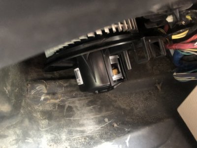

Just an update I located the fan motor and checked connections all seem ok. I tapped the fan housing with my hammer lightly and it jump started and ran.
Knowing this it’s a motor, ordered a Motorcraft. Basically the module was a waste, however the connector was shot.

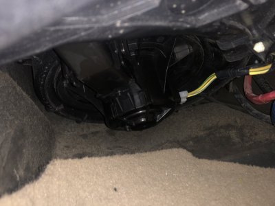

Problem fixed with new motor, works great! Blower install took about 20 minutes with removal and installation of new unit. I looked online and there aren’t any videos/ instructions for our model year. The book rate is high and shops and dealers want to remove the entire dashboard, NOT NEEDED!!
Yes it’s a fight to get it out but it’s doable. Peel back your carpet first thing and unplug the old unit. Twist it and it will drop out as it’s held in by tabs. You have to work the old one out past the sound deadening and same when going back in. I used my long screwdriver to slightly flex the fan cage to get it to drop into the housing.
