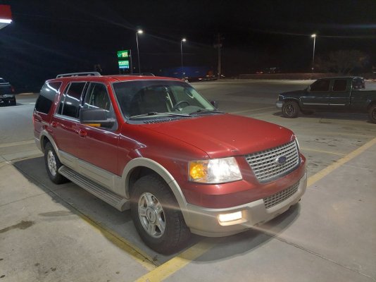

Hey all, been creeping on the forums for a while now. My kids mom offered to sell me the 2006 EB Expo they had before they upgraded to a diesel for well under the BB. Finally got the money together to buy it and have to say it's amazing going from a 03 Mazda 6S to the 06 Expo. It's rust free and ask the paint is good. 139K miles and has had a ton of work done recently. Luckily a full tuneup was just done including all new injectors. The 10 ply all season tires only have 6k miles on them. So far the only issues it has are the rear ac/heat click, the DVD player won't stay in the up position, the pass front window is slow going up, the driver side has a bad switch that only rolls the window up when you hold your mouth right, and the pass side Cat is bad. All things I believe are in my skill level to fix. For $4500 I've got no complaints.
