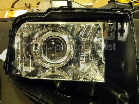

just using butyl rubber for sealing, heating and clamping them back together, have a total of 4 different kinds of projectors here to play with, all from theretrofitsource, fxr1.1, fxr3.0 from ebay, mini h1, and mini d2s. will probably just use one of the easier ones like the mini d2s or mini h1 for now.
have to say didnt realize how much SMALLER our lights are compared to f150 lights.

Thanks for the advice btw i used 2 butter knife like blades, made everything easier in breaking the seal between the permaseal and the lens.
i originally planned to use mini h1's, but got mini d2s to try, oversized my hole, so now i'll be using fx-r. hope to get this done soon. the apollo shroud that theretrofitsource sells is a perfect fit without any cutting into the reflector.

managed to start test fitting, used a fxr 3.0 projector, lots of cutting, but it is a solid projector. just need to clean up my old adhesive, and make sure all the chrome is clean, then sealing it back up.
F
FormerStangFan
Dec 13, 2011
48
California
That actually looks really natural in there. I can't wait to see the finished product. I think I may want to do this also. Thanks for the pics!
