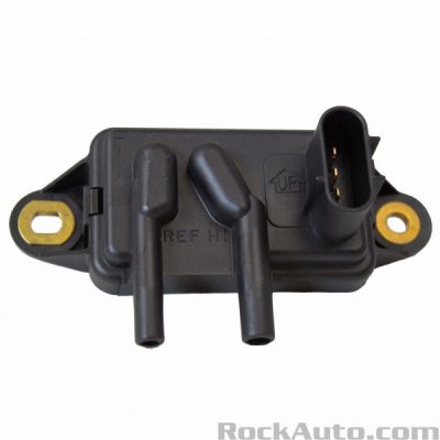

RichardH
Nov 20, 2015
284
72
TX
Sounds good ! If you end up replacing the DPFE sensor you can find them over at Rock Auto as well as the correct hoses.
https://www.rockauto.com/en/catalog...sion,egr+pressure+feedback+(dpfe)+sensor,5088
Hamfisted,
I must start by saying that I entirely appreciate the feedback you have shared with others, myself included when I had a question.
I bought, installed new EGR valve, DPFE (aftermarket) and hoses. The Aftermarket one failed me from day one, CEL kept coming back. Scratched my head. Finally had to go to the dealer and they installed a Motorcraft one after figuring out it was faulty, and voila problem solved.
Now I agree my DPFE malfunction could be an anomaly, but the headache it caused gave me pause on certain aftermarket items for my expy. OP, if you do go aftermarket, give the part a good shake down so you can replace if need be.
GL
Hamfisted
Nov 20, 2012
2,594
1,476
Ft Lauderdale
Rich I would agree you can't go wrong using factory Motorcraft whenever possible. Rock Auto offers Motorcraft for this part as well as other brands that are a little cheaper if you have to go that route for your budget.
