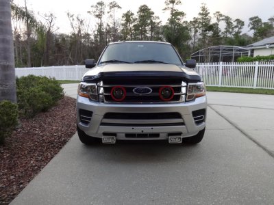

Here's a pic of my 2017, I removed the LED housing and added Hella fogs under the bumper and also added Hella pencil beam spots behind the grill, both of these use halogen bulbs. The OEM fog holes have a small mesh grill in them.
