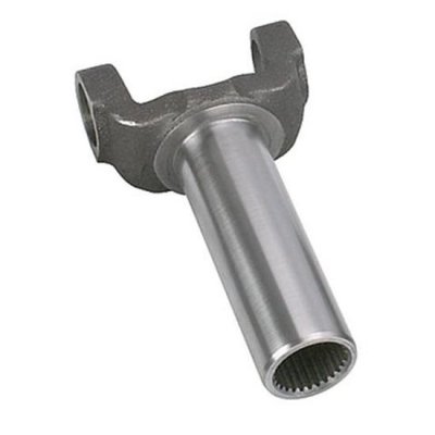

Sorry I missed your reply, haven’t looked at this thread. I’m referring to the downshift bump/clunk that sometimes occurs where it almost feels like getting hit lightly from behind coming to a stop. Sounds like you have it. This is documented on early 6R75&80 transmissions in the Expedition and F-150. Many F-150 owners attributed this to the slip yolk lacking lubrication on the splines. I recently replaced my driveshaft assembly which came with a new greased slip yolk and the bump occurs much less frequently, if at all. My old one had no grease inside, the new one came with a lot on the splines. The slip yolk is what goes into the Transfer Case or Transmission depending on drive type, it allows the driveshaft to move forward and back with changing load and the older ones stick up.
Here is a slip yolk:

Guys if you could sit under your truck while it’s under way you’d see the slip yolk does a lot. Every time you accelerate or brake your rear suspension is going up or down, and the diff is moving. The driveshaft has to move in or out to compensate. When your driving the rear suspension is under varying loads, and that load is changing depending what you are doing.
I’m confused, are you guys suggesting the F-150s diff and rear suspension moves under various acceleration/ deceleration loads but the Expedition does not? If so, how is this possible?
My old driveshaft, like the original F-150 shafts, relied on a nickel coating. The new yolk (like the newer F-150 yolks), had fords special grease in it instead of relying on the nickel coating. At some point Ford acknowledged there is a problem with the old driveshaft. They also sell repair kits with a new yolk and grease for the old one.

Agree to disagree I guess, when I was under my expy I can see a line where the yolk goes and and out against the rubber seal on the T-Case and I can tell you it moves generously.
