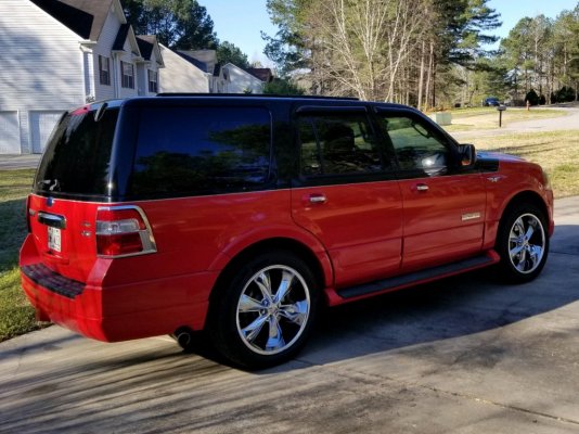

I had the same issue and decided to purchase new wheels and tires - I upsized from 20" to 22".83175.jpeg
