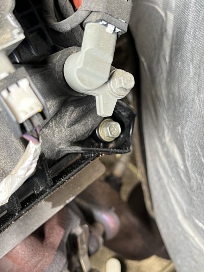

I checked it out and yep you were right on… There is oil buildup all over both valve covers. I took a video but couldn’t attach it so here’s a screenshot.IMG_7430.jpeg

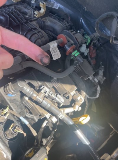

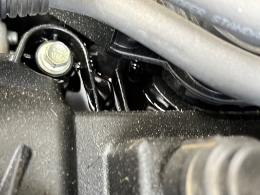

Well my driver side is leaking now. Factory cam phasers. I smelled oil burning and thought somebody in traffic was losing their engine. Then I got out for gas and smelled it worse. Pulled the cover at home and sure enough it was puddled at the top in the front, and had run down the back and onto the exhaust. Goes in Tuesday.
Keep us posted how your service experience goes.
