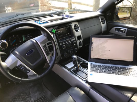

Finally found a moment to make all my much anticipated changes today:
1. Disabled turn signal hyper flash
2. Disabled green dash indicator for fog lights
3. Enables LED fog lights as DRL’s
4. Disabled seatbelt chime driver and passenger
5. Disabled double horn honk when vehicle is running and key is in my pocket and I exit vehicle and close door.
6. Increased turn signal bump from 3 flashes to 4.
Thrilled. ForScan is powerful.
I do have a question:
Key in ignition chime and Daytime Running Light Options on Left Side Screen indicate changes to the same module address and even the same digit in the address. I’m asking because I’d like to turn off the key in ignition chime but don’t want to mess with it if that’s a typo. Can anyone confirm? I’m referencing the spreadsheet.

I can confirm that the key in ignition chime worked in my 15. I suspect that based on the codes (8 is chime enabled but DRL off, C is chime enabled DRL on), that putting a 4 there would actually enable DRL and disable the chime. I just haven’t bothered trying it.

Is there a way to disable the key fob panic alarm? A spell of cold weather here has put me in gloves this weekend and I've already pressed the panic alarm at the same time as the lock button. Frankly have no need whatsoever for the panic alarm. A software solution would be preferable to cracking open the fob and insulating or cutting the contacts. :)
-- Chuck
AllBoostNoEco
May 2, 2017
328
196
GA
In the 15-18 F150 and 16-18 Exploder it’s BCM line 726-37-01, but that doesn’t correspond with our trucks.
726-15-01 is the door keypad enable/disable; -16-01 is Smart Unlock; and -19-01 is Remote Start.
That being said, you are moving into uncharted territory across the model lines for our particular coding.
I’d look at changing 726-17-01 and 726-18-01 to see what effect it has.
-17-01 should be 0101, so try changing it to 0001 and 0100 and seeing if there is any effect. I’m thinking it’s possible one is the horn and one is the lights.
If not, move on to -18-01. It should be 0100 0000, and you could try changing it to 0000 0000 and seeing if that works. If not, I’ll dig down into the later lines of code and seeing what else could be it.
