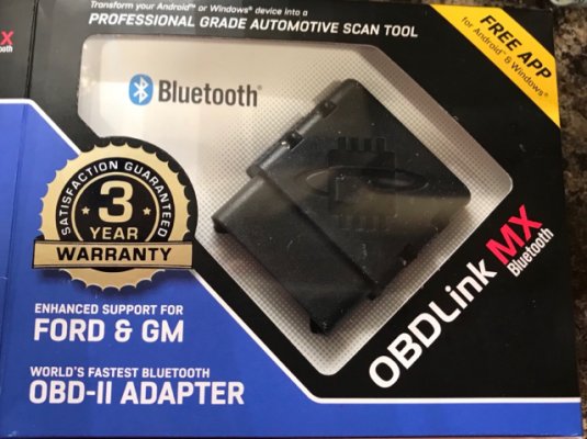

Look what came in the mail today. But I’m flying to Tennessee for the weekend for work, so I’ll have to wait to play [emoji30]
