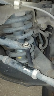

Last couple of weeks I have been hearing a light "tinking" sound when going over bumps with my windows down. After looking several times, I finally found the source. The front sway bar connections on both sides are VERY loose. Both bolts have at least 2 to 3 inches of play in them, but the nylon nuts have not loosened any. I assume there should there be some kind of hard rubber pieces there, but they have rotted away and fallen off. Any brands you guys recommend or stay away from? Attached a couple pics in case they help someone in the future.

Yep, the links are bad the bushings are gone , just go to the parts store and buy the front sway bar links. They come in a kit

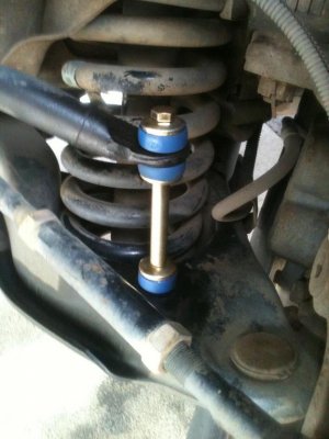

Thanks, I finally found a picture for reference. Can't believe I didn't notice this the first few times I gave it a once over. This probably explains the front end roll-over I've noticed lately. Anyways, any brand recommendations?

Just don't over tighten them. The washers can bite through the urethane and destroy themselves very quickly.
While you're at it, you should check all the rear linkage bushings. Energy makes urethane replacement for all of them.
If you want just better than syock then go with moog or go with energy, tighten them till the bushing is the same size as the washer and your done
