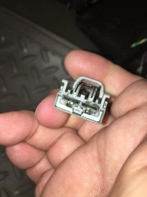

How can I tell if my front ac blower is out or the resistor is out? Back works fine.
The fan was coming on sometimes and stopping. Now it will not come on at all.
I am getting prices on replacement and its like $500 for something I can do in my yard in ten min.
I just dont know how to tell which part to buy.
I have attached a picture of the plug that plugs into my blower motor. It has black marks on it. What does that mean?

If it runs fine on top speed, but intermittently or not at all on lower speeds, the resister or wiring to it is defective.
If it doesn't run at all on top speed, it's either the wiring or the blower motor.
Check that plug and the wires going to it. They are known to deteriorate and require replacing.

The black marks may be from the plastic when the connections overheating.

Those don't have the old style blower motor resistors. Yours uses an electronic module (blower motor control module) that fails over time. You may need to repair or replace the plug also.
