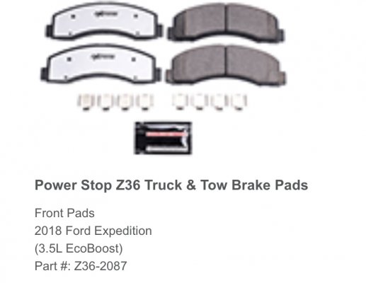

I’m interested if the semi make an improvement in stopping distance.

The truck seems to stop better, but thats all subjective, I have no data to back up that statement.
