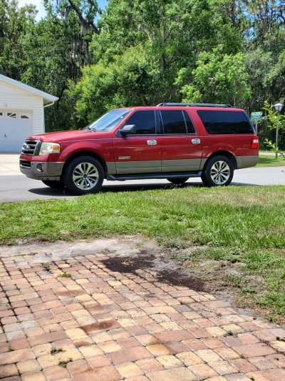

My front doors seem to hold water when going through the car wash, or it rains really hard.Any solutions other than drilling holes on the inside of the doors.
