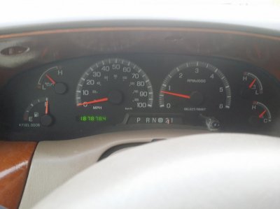

Well this fourth problem since my gear box fault last week . Which also suspect is electronic related. So now My fuel gauge had given up, and the low fuel light is on. Where is the location of the fuel sensor? I've tried resetting the Ecu but no difference at all.

Inside the gas tank. Not meaning to sound like a smart ass, check the fuel level before doing any work on the fuel level sensor. You can simulate the sender by varying the resistance level input to the gauge. Let us know if you want to try that first before changing out the pump/sender assy.
Well what happend is the level was showing near just little above empty, and it was not accurate because the engine was about to cut out from a lack of fuel in the tank. I filled it with a full tank of gas and then the no fuel light came on and the gauge was dead. I would like to try and simulate the sender.
And the gauge seems to have reset itself and is now showing full tank of gas but I highly doubt it is the case

Wait for a while and see if the problem returns. You can use the trip meter to help gauge your fuel usage if you know what mpg's you were getting.
