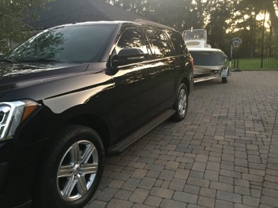

I could see the rear springs sag down with my 2019. My boat & trailer is around 4000 lbs and I don't have heavy tow package.expeditionboat.jpg

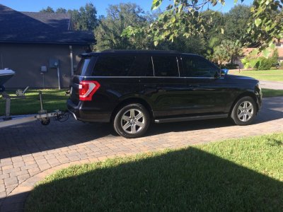

My boat/trailer is 3,254lbs and I still have rake without the HD tow package:
3C16402A-1720-4013-9B12-0CB328D25710.jpeg 5BFD725D-E43B-40FF-84D9-E6CB2B9F89CE.jpeg

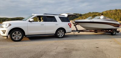

Here's my setup with the Sumo Spings on. +/- 550 lb tongue weight, with some stuff in the cargo area.
