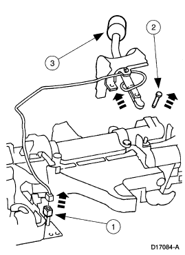

Changing out the steering column gear shift requires removing the ignition switch lock cylinder and steering wheel. To remove the steering wheel, you need to remove the driver side air bag, which requires deactivating the air bag itself. That needs the computer that the dealer has.
Once all that is removed, take off the upper steering column shroud and then remove the gear shift lever.

The key is not releasing the key probably because it "thinks" that he isn't in park. It won't let you slide out the key unless you are in P. FWIW, you can't start it unless you're in P or N.
