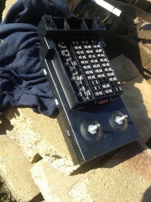

Hi guys ! Not sure if I can jump in here. Apologize if not. 98 EB 5. 4 / I have fuse box & gem out to clean & inspect. Trying to get fuse box apart to clean, tighten up, whatever I find. Copper plates & such. My question is about the connection that goes thru fuse box that holds wiring harness to box & box to frame under dash. Are they pressed in ? That's what I think. Two of them on upper part of box. Aluminum. How to get them out to separate fuse box & get inside ? Or at least know what those type of fittings t are called ? Thanks for any helpful tips.
ft 57
Jul 21, 2016
Minny
Thanks for responding! Wanna get my fuse box apart to inspect & clean. Hung up on some sort of riv-nuts I believe. Experience with these anyone ?
stamp11127
Mar 10, 2012
6,207
1,246
Temple, Georgia
Never has to open one of those and they do look as though they press in. If you have a heat gun you may give that a shot on the low setting.
