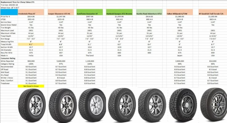

I love the Michelin Defenders / LTX and have them on both of our Expys (2011 / 2017) in 20" size. They are great in dry, wet, ice and even medium snow, but I'm not sure I'd recommend them for northern Minnesota conditions. Maybe others that have used them in those conditions can advise. I don't know if this will help, but earlier this year I was looking for replacement tires for our Tahoe Z71, which I plow with and wanted tires to handle the worst winter conditions. This is the comparison chart I came up with. Note that these are 265/65/18 tires. If you want the original spreadsheet, DM me you email and I'll send it.
