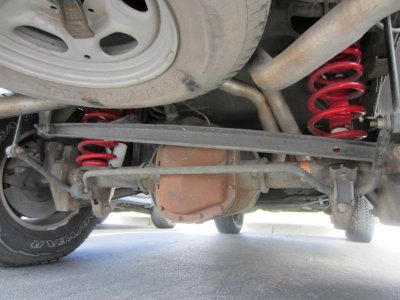

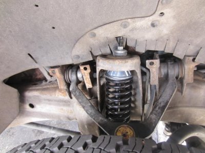

Ok guys check this out. I had some 4" Rancho lift springs for the back that I had on a while ago and just put them back on. When the wife ( she who must be obeyed) was driving it she didn't like it so I put stockers back on. I also added some pro comp 4" shocks to the back. Now on the front I had installed some lift keys about 2 years ago on it and hadn't really done anything to it since then. About 2 weeks ago I replaced upper control arms with ball joints, lower ball joint, tie rods (inner and outer), and sway bar end links. Yesterday I put some Monroe sensa traks (58518) coil overs on the front. I only had to crank the torsion bars about 1/2 inch to get a rake to it. The front sits at 38 1/2 from the ground to the fender and the back sits at 39. I think it turned out nice. The ride feels much better than the shocks I had on the front. Now all I need its bigger tires. Let me know what you think.
