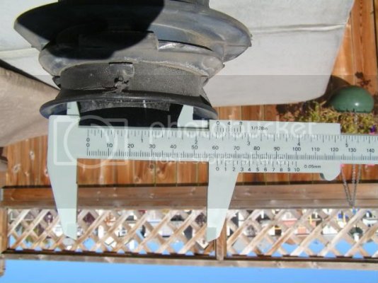

So I just measured my 2006 up for the Gott's Mod here is what I have found out with photos. On the 2006 it's a single piece and you will probably have to hack it up a bit... that said the photo's speak for themselves - 2 3/8" unobstructed in mine - the calipers on the opening do not lie.
Has anyone in here done this already to a 2006? or other similar year with the same set up - I might have to be the first - however there is no going back after I take a saw to the end of this intake...

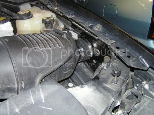

So I just completed my Gott's Mod on my 2006 Expedition - here are the photos and details - I have not yet tested it yet - gotta wait until the Permatex Dries, and of course until tomorrow - I had a few bevies while doing it.
3 1/4" of breathing room... this is a PVC to ABS adapter so it's a little thinner than the standard 3" ABS - it's also easier to make fit into that not quiet round hole in the fender well - I still did a little sanding with a "dremmel" tool to the interior and exterior to smooth everything out

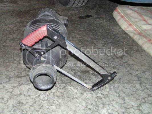

I'm committed now! Off with your head! (b)

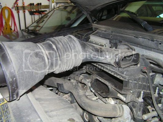

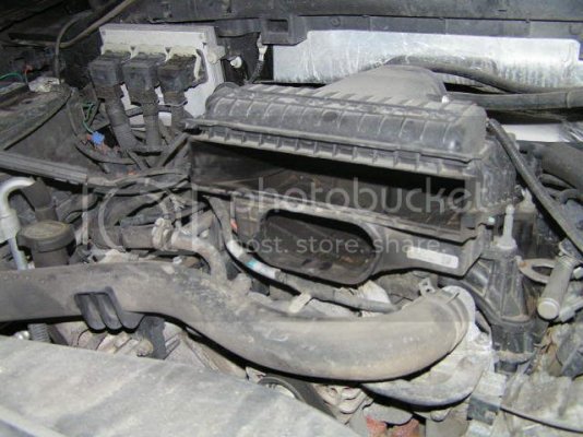

Photos of the intake, rubber adapter, and part I cut off
Rubber adapter with a little black silicone to seal the exterior - not on the inside so it should not ever get sucked inside - gotta love Permatex
Finished - completed all installed - now I gotta test it.
