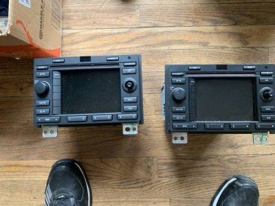

Hello to all,
I have the chance to pick up this gps/cd player for my 2003 Eddie Bauer Expedition. I currently have the 6 cd changer installed with no GPS. Does anybody know what else I would need to make the swap? I searched the site for info but didn't find anything. Any info would be appreciated. I really enjoy this site...I think I have spent more time reading/enjoying on here than driving "Shannon" Thank you again...
Jim

Here is a pic of the unit I'm thinking about buying...I am assuming it is not a 6 cd changer. Thanks.....

As a complete novice re car audio installation, I just want to know if this swap would be "major surgery" or pretty much plug and play. If there is a thread re this that I overlooked, please feel free to let me know. Thanks for your time....
Jim

I never worked on an 03, but I did the job on my 08. Your unit, if it was offered as an option in your year should just plug in. You will need an antenna for the GPS that usually mounts on the reinforcement under the dash. Magnetic after market ones are available.
If your car doesn't have steering wheel radio controls or a sub woofer and the navigation is programmed for them, they obviously won't work. You may have to make a harness to add those features. And if the unit is programmed for a subwoofer and you don't install one, you may lose the low sound.

That particular nav unit was OK at best in 2003. If this was 2004, I'd say go for it. Today I'm not sure I'd consider it.
You load multiple CD-ROMS of map data into the unit. These were Ford-specific and I don't know when the last was made/updated. At the time there were multiple discs, like a NE USA, SE, central, Canada, etc. Later Ford navigation discs held these 5-6 discs on one. Pretty sure this unit isn't backwards compatible. (ie: hard drive versus disc)
With this unit, audio CD's were loaded into a center console mounted 6-disc changer.
Flexpedition,
Thank you for your reply. Based on what you're saying, I think I am going to forget about swapping these out. I appreciate your input. Seems like I won't be happy with the result.

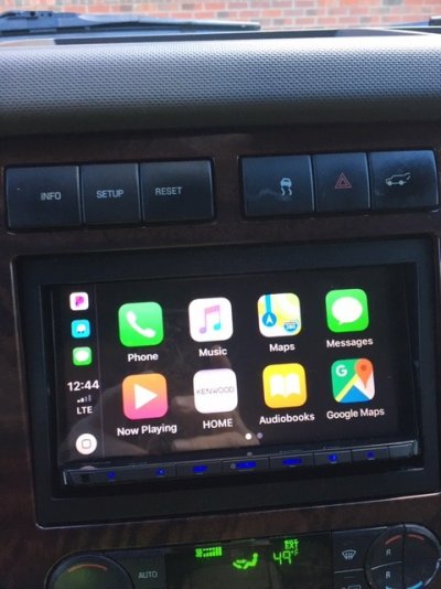

Check with Crutchfield about options for your year Expedition. I got a nice Kenwood from them and a plug and play harness that allows steering wheel control.The unit has all the latest options like Apple play and several GPS programs.
Uses the OEM speakers with no new wiring.

Good morning and thanks for your reply...I like the look of that unit. I still haven't changed my existing set-up. We don't own a cell phone, so my uneducated concern is that most features will be useless without one. I need to do more research on it before I make the leap. Thanks again for your reply....
Jim
My Kenwood uses Garmin as its base nav . Also I have Google map, Apple map and Waze.\ as a part Apple car play.
