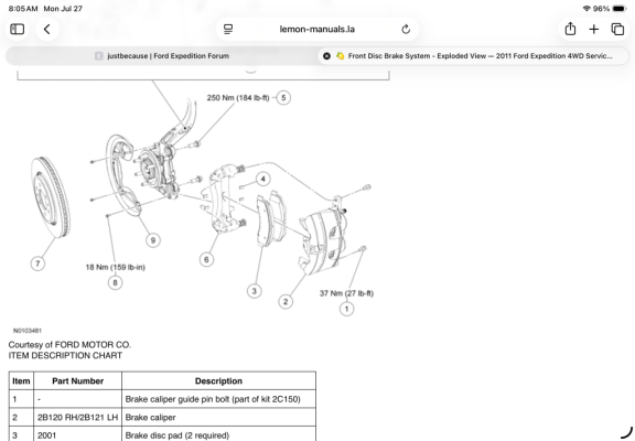

I'm fighting my own botched brake job right now
I ordered bosch pads the 4 initially looked identical now I'm realizing they are symmetrical but 2 have dimples and two have bumps. which goes where I cant find a source and I've been reading all over. I threw away the "instructions" that came with the pads I dont remember them being in depth just "install them right or you could die" sort of paperwork and what I can find online from bosch isnt anything like install instructions. even the PDF from the website for my part number is just an info sheet and says go to their website for more info. I cant find any more info on their site.

The reason for the humps is so the caliper pistons can press evenly on the pads. (More surface area).
