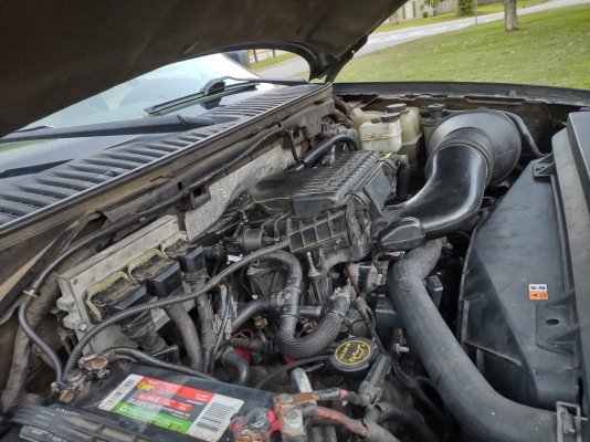

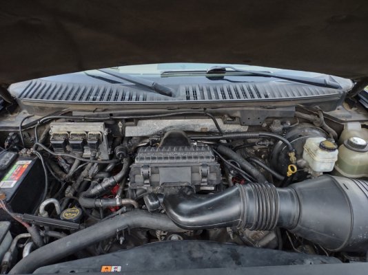

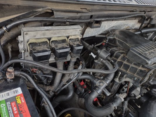

Can you post pics of the engine bay of your Expy ? Particularly the throttle body area where vacuum hoses run. The hot water valve also. Are you getting a check engine light, or any DTC codes ?

301 and 308 before I changed the coils, nothing since. Will get pictures within the next hour- thanks much!

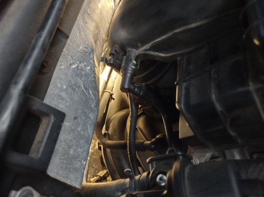

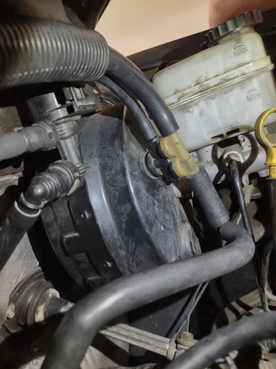

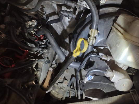

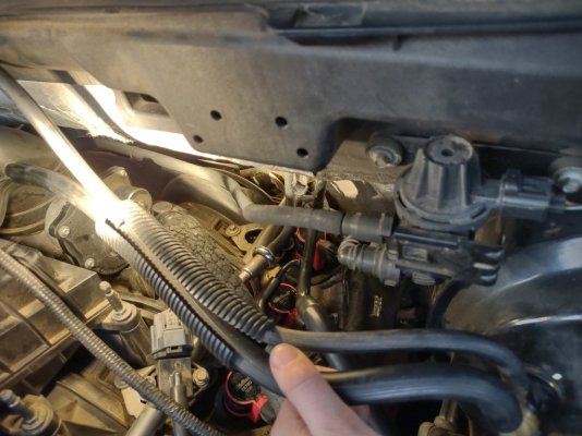

That hose that runs along the back is not in the best shape but with how dramatic the problem is I kind of thought I had put a hose somewhere it shouldn't go instead of it just being an older hose. Either way I'll be changing that one out tomorrow just because I'm out of ideas

Yeah, I don't see anything obvious. You may end up having to check the intake and vacuum hoses with a smoke machine to find any leaks. The loss of vacuum only happens when you step on the brake pedal ? You could disconnect the booster's vacuum line and plug the hose, then with the engine running step on the brake pedal and see if the loss of vacuum problem goes away. That would kinda point to the brake booster diaphragm leaking. Do you hear any air noises from the brake booster when you or an assistant steps on the brakes?

Made a diy smoke test and the billowing smoke from behind the engine was enough to motivate me to get serious about where the back hose goes. Wriggled, twisted, and cussed til I got the hose back on it's little metal offshoot on the back of the engine. Skinny arms can access it from under the driver's side with a great deal of determination and nothing being removed.
