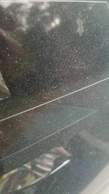

So since I got my 08 Expy the headlights have been less than perfect. They're not cloudy the way I see on so many other cars. This looks more like crazing on the inside of the clear plastic. On top of that there is now moisture inside of my passenger headlight so it looks like I might be on the hunt for replacements.
Anyone know of some decent replacement options that wont break the bank? Are there any brands to avoid altogether?
