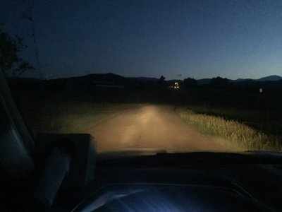

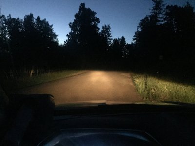

i shot these images going downhill last night after the headlights were 'adjusted' at the dealer that morning.
John Christopher
Jan 8, 2017
393
80
CT
That's somewhat better but nothing to write home about. Did they actually have to take the bumper and other parts off to adjust the lights?
M
Markg2
Jun 1, 2018
79
Evergreen, CO
Not only the bumper but... the consecutive, dedicated time that the mechanic spent on this was an hour and forty-five minutes (I was at the dealer for ~2 1/2).

Second, the mechanic did increase the low beam field of view. I drove the vehicle for short test run around Horseshoe Drive last night.
The attached images represent the view out the windshield ‘going downhill’. A decline represents the most restricted of the restricted visions. Approximately ½ the driving time in Evergreen is downhill—the drive to Denver on I-70 is all downhill. Although the low beam field of view is better than previous to yesterday’s headlight adjustment, I think any reasonable person would agree the field of vision is restricted, unsafe, dangerous and unacceptable.
As before, I maintain that the XLT low beam projector design is a seriously flawed and dangerous design defect. Ford clearly did not consider mountain roads in their design considerations.
The 2018 Expedition is an excellent vehicle throughout with this one glaring exception.
There is at least one fix for this condition. Install the Platinum, LED housing in place of the halogen projector housing. I’ve seen through the windshield images of the LED low beams and they do not exhibit the restricted view of the XLT.

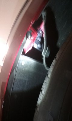

As far as bulb replacement on the Expedition, the bumper does not need to be pulled. I have a 2018 Expedition and can change either side headlight bulb, high or low beam, in fifteen minutes. A lot of mechanics have not figured that out yet. There is a seam in the wheel liner with a fold area on the upper liner right in front of the wheel. Remove the single screw on top of the fold line and fold the upper liner out to the the tire. The headlight bulb assemblies are right there.

Use a 7/32nds or 5.5mm socket to remove this screw to gain access to the back of the headlight assemblies and change bulbs.20180725_173924.jpg 20180725_173804.jpg
Pull the liner up, remove rubber covers and untwist bulbs. Unclip wire harness from bulb(may require two hands) and remove bulb. Installation is the opposite. Be careful not to touch glass portion of bulbs.
